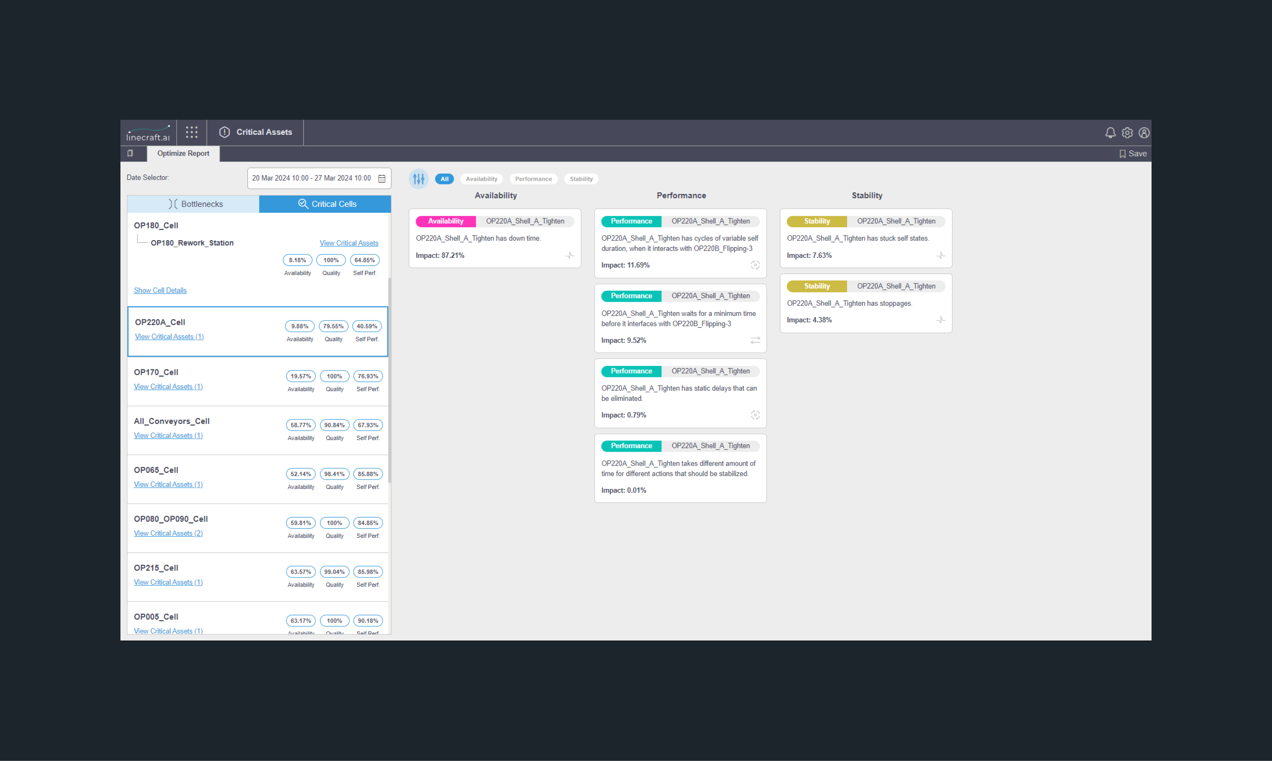

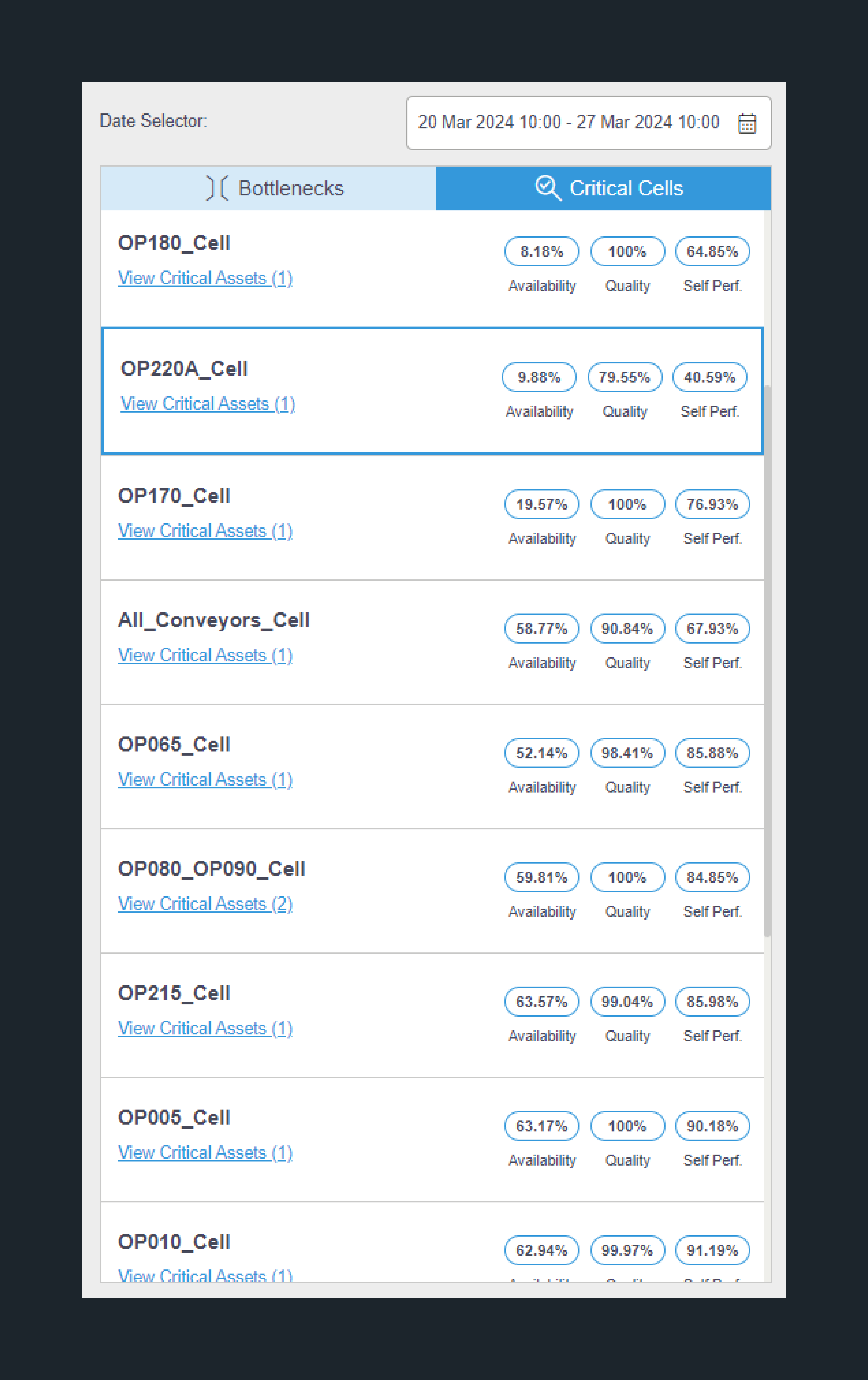

1. Critical Cell Summary
The left of the page will continue to show the critical cell summary with a list of all the critical cells and assets in the selected date range.

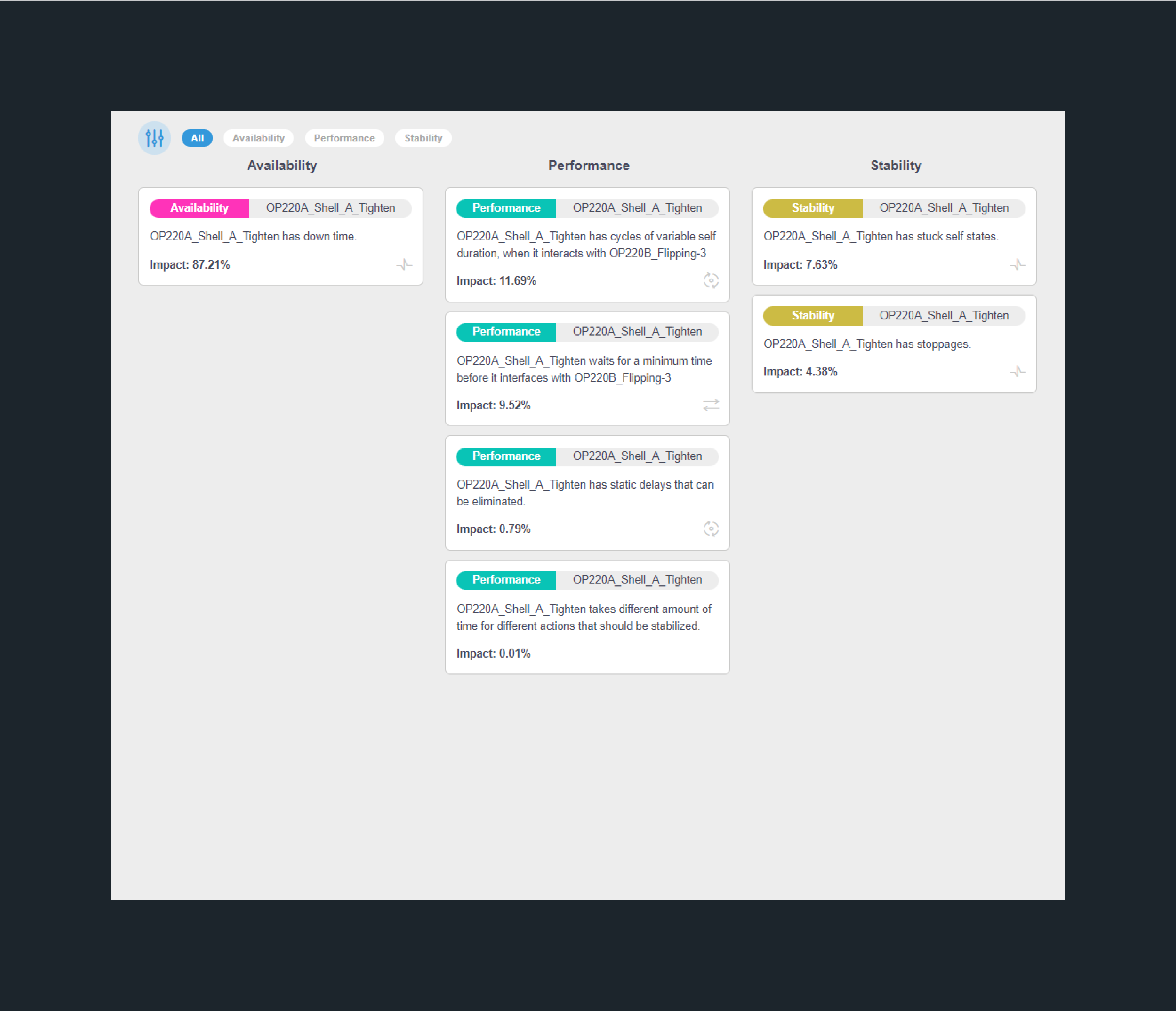

2. Opportunity Cards
Opportunity cards describe the opportunities pertaining to the asset within the critical cell, the type of opportunity as well as the potential impact of addressing the opportunity. By default when a cell is selected, opportunities for the first asset will be shown.

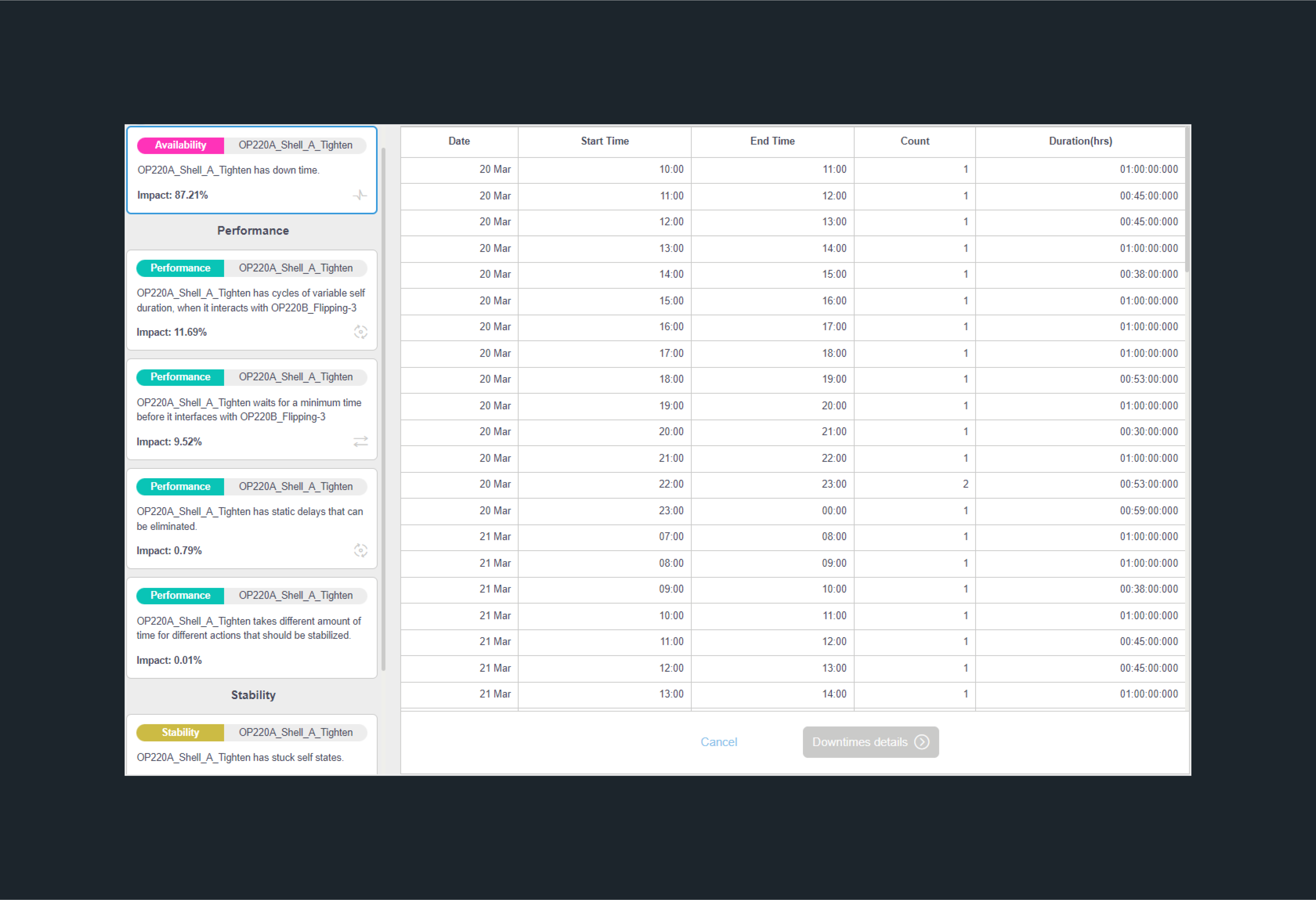

      a. Availability Opportunities
Availability opportunities are down time opportunities that are caused by assets in a cell being down and unavailable to produce. These generally explain the root cause of critical cells but are not necessarily actionable.
To drilldown into an availability opportunity, click on the card pertaining to availability opportunities for the selected asset. This will open a section that shows you all the hour intervals in which the selected asset faced a downtime along with the total number of downtimes in that hour and the total downtime duration.
From here, you can select an interval and move into downtime details from the button available below. This will take you to the downtime details page for the selected hour.

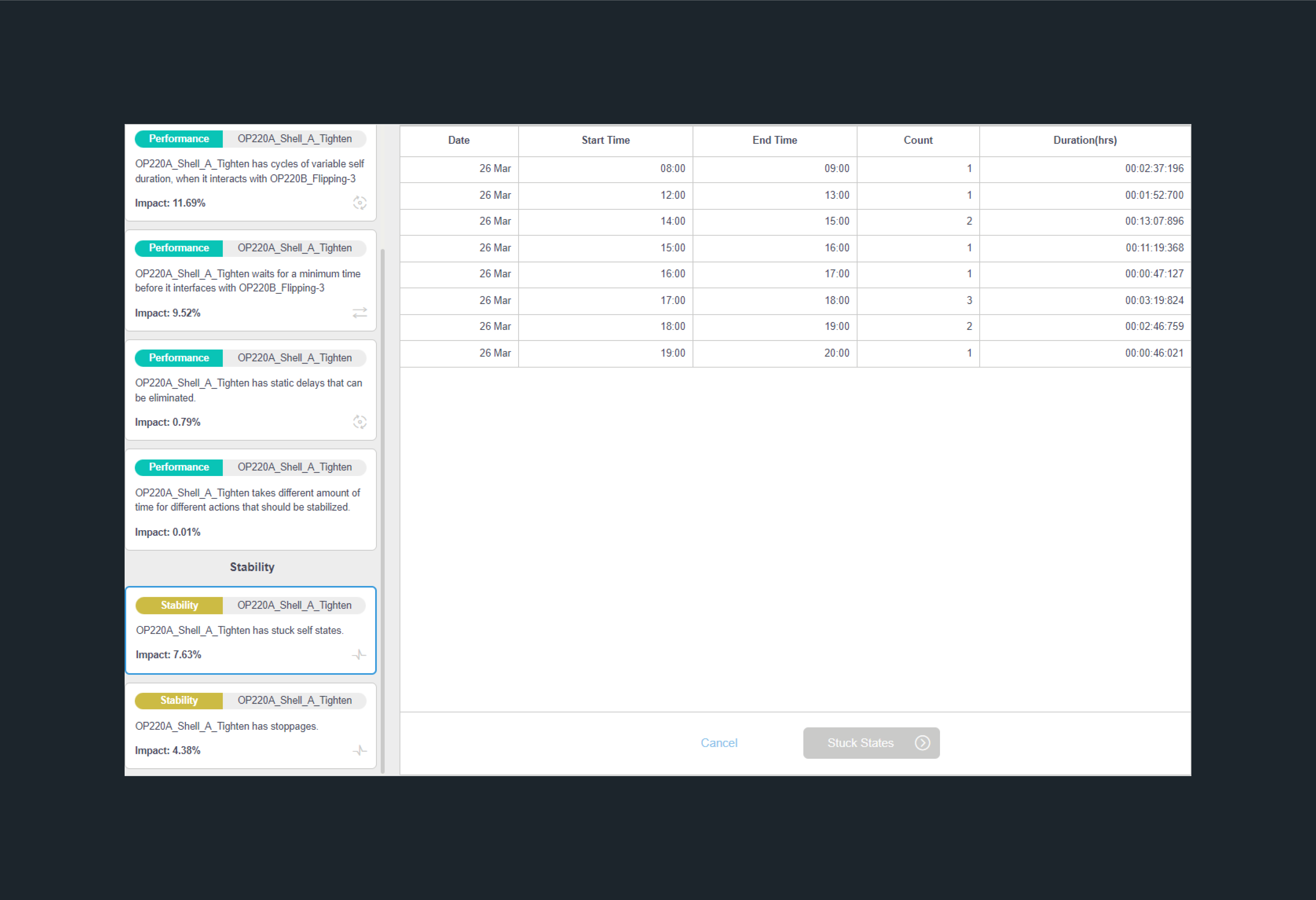

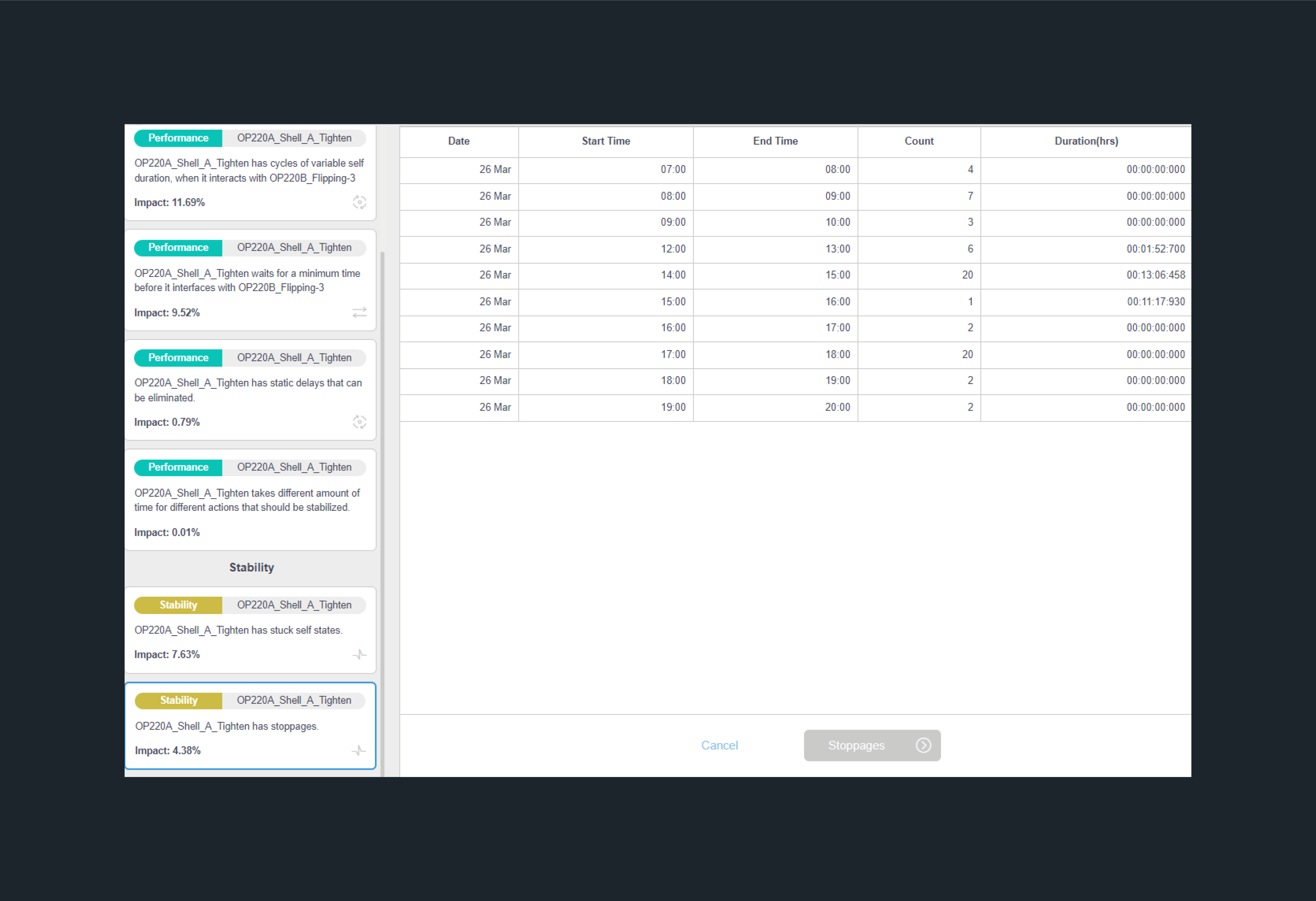

      2. Stability opportunities
There are two major types of stability opportunities. These are stuck states and stoppages.

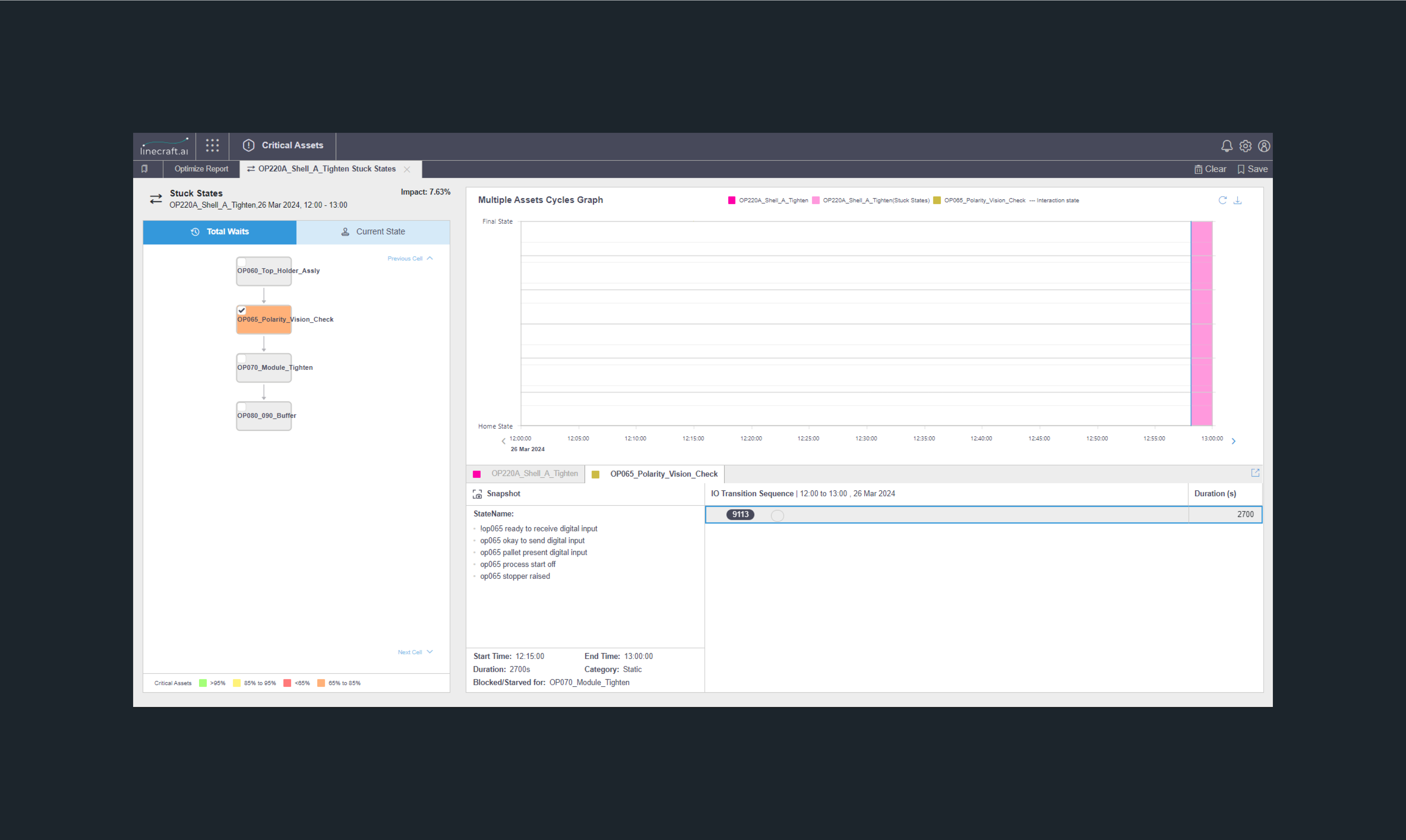

Stuck states are events in which an asset is cycling but gets interlocked in a suboptimal state. To drilldown into a stuck state opportunity, click on the card pertaining to this opportunity for the selected asset. This will open a section that shows you all the hour intervals in which the selected asset faced a stuck state along with the total number of stuck states in that hour and the total stuck state duration. From here, you can select an interval and move into stuck states from the button available below.
This will open the cycles page for the selected hour, with the stuck state/s highlighted.

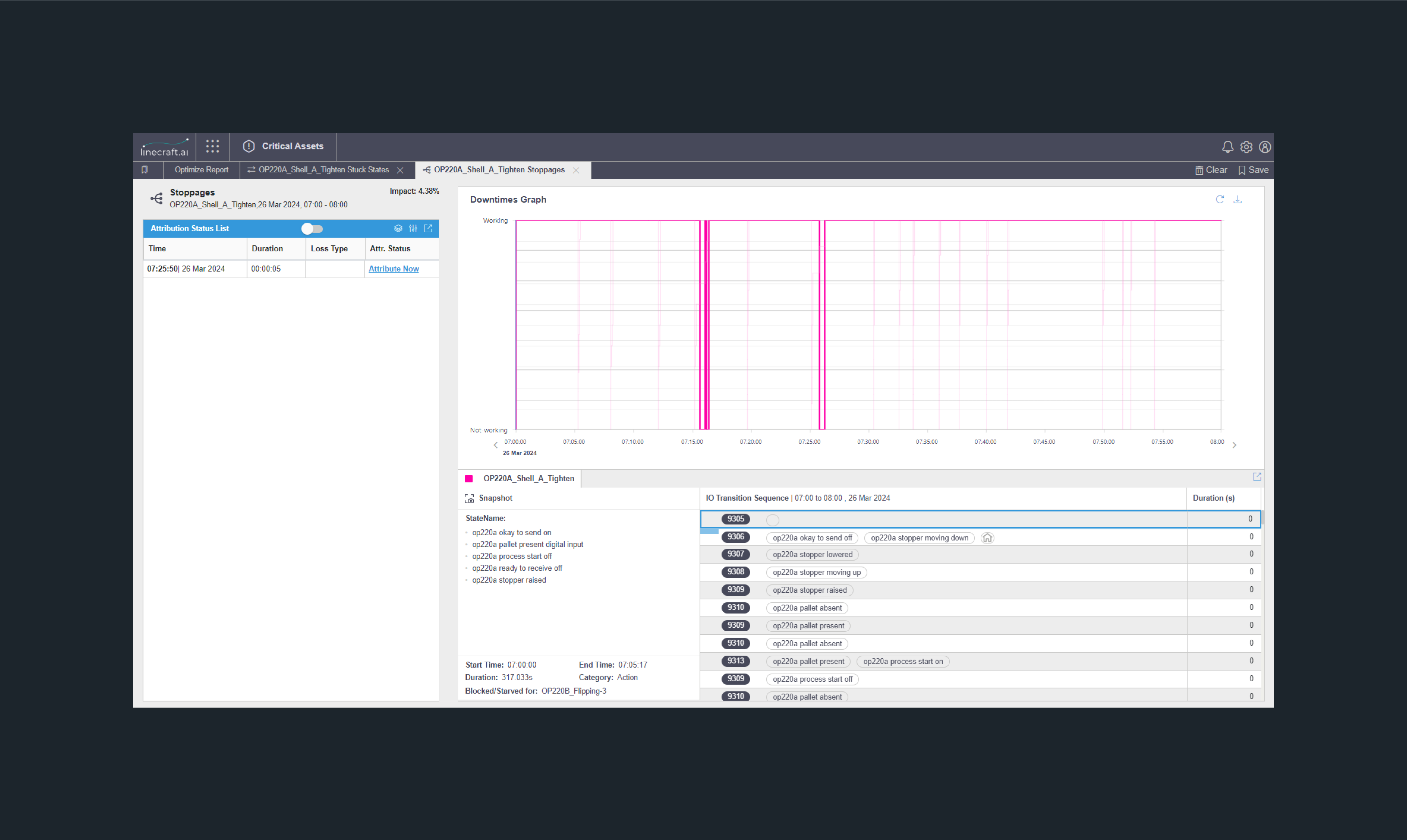

Stoppages are events where an asset is down for 15 minutes or less. To drilldown into a stoppage opportunity, click on the card pertaining to this opportunity for the selected asset. This will open a section that shows you all the hour intervals in which the selected asset faced a stoppage along with the total number of stoppages in that hour and the total stoppage duration. From here, you can select an interval and move into stoppages from the button available below.
This will open the downtimes page for the selected hour, with the stoppage/s highlighted.
