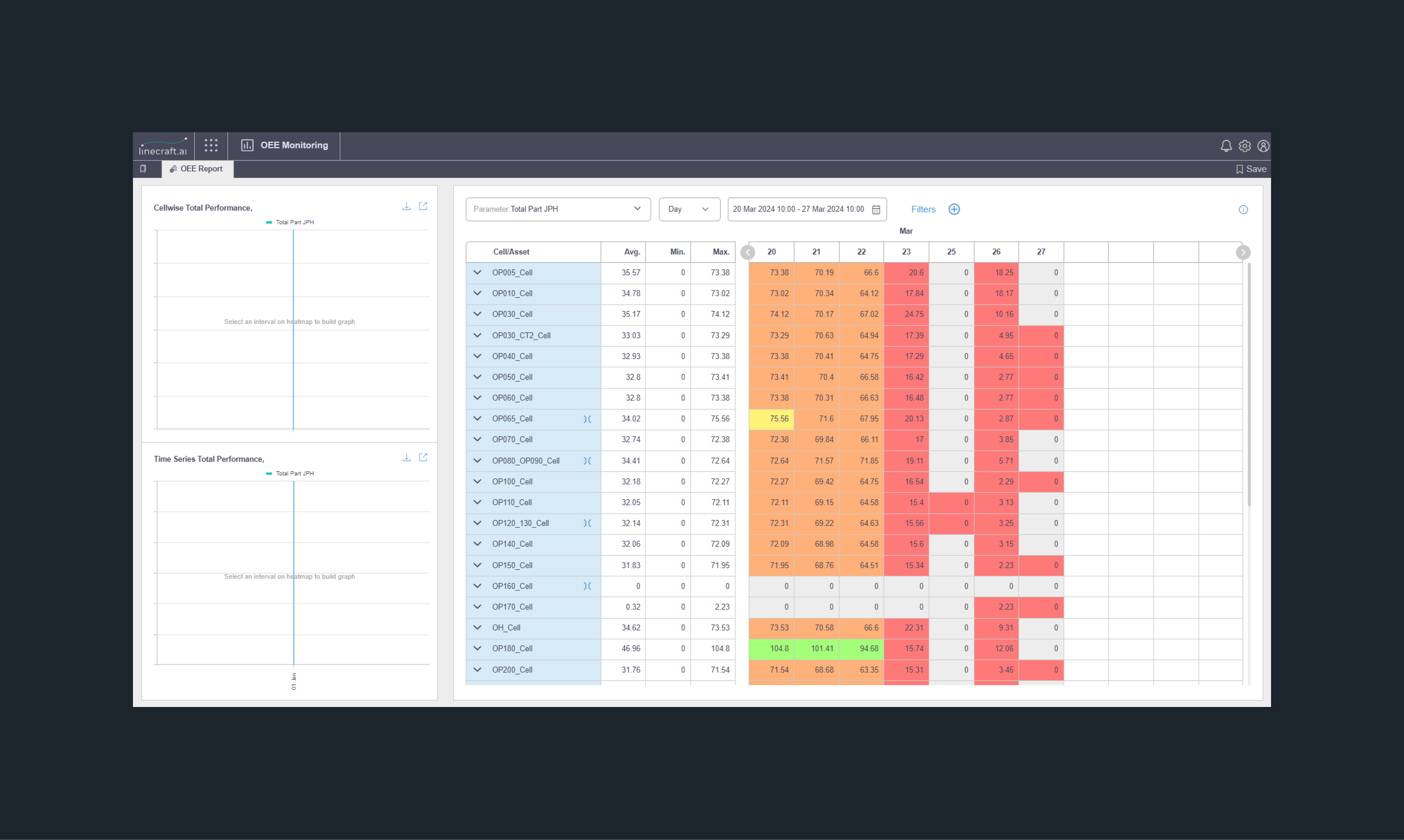

The Total Part JPH report shows the total JPH of all the assets and cells on the line
The Total Part JPH page consists of the following:
Heatmap
The Total Part JPH heatmap that allows you to look at the Total Part JPH of all the cells and assets on your line at an hourly or daily level for the chosen time range. The heatmap also shows you your average Total Part JPH for the cell or asset over the selected time range, along with its minimum and maximum value.

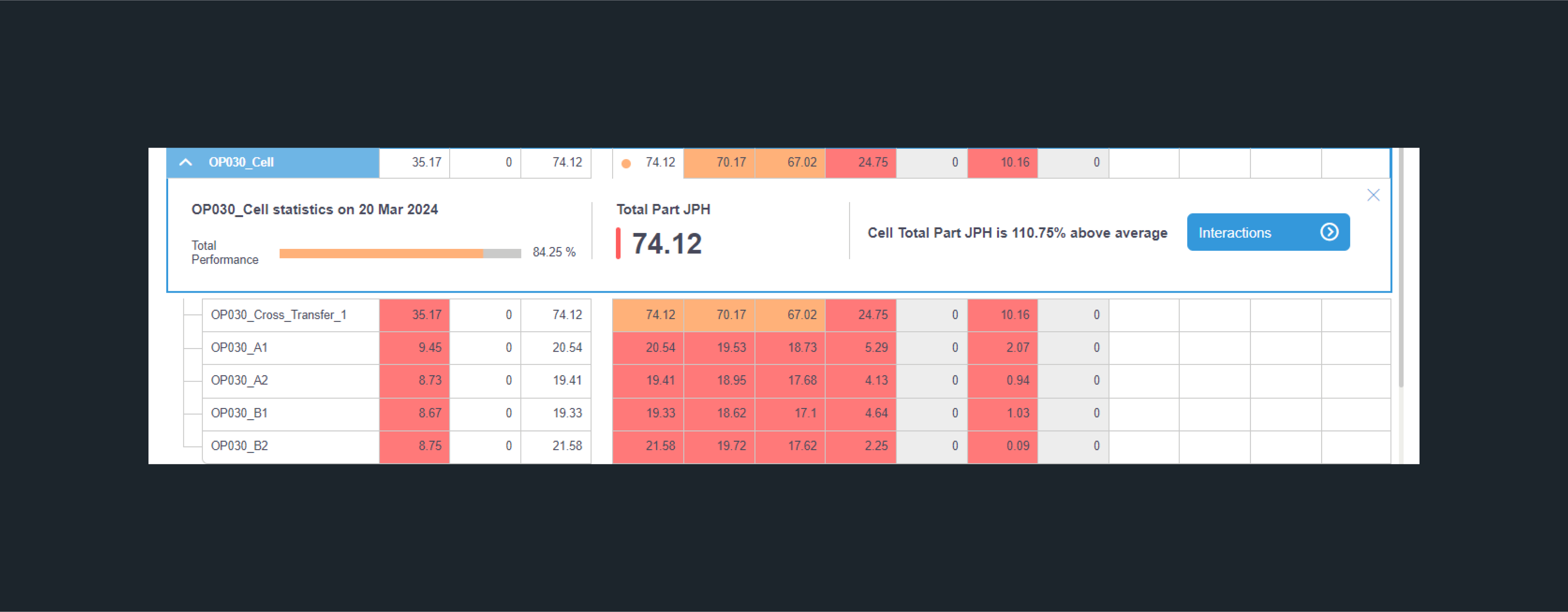

Cell Interval
Selecting a cell interval shows the Total Part JPH cell summary for that specific day / hour on the heatmap. Clicking on the cell interval allows you to drill down to Interactions (Cell Performance).

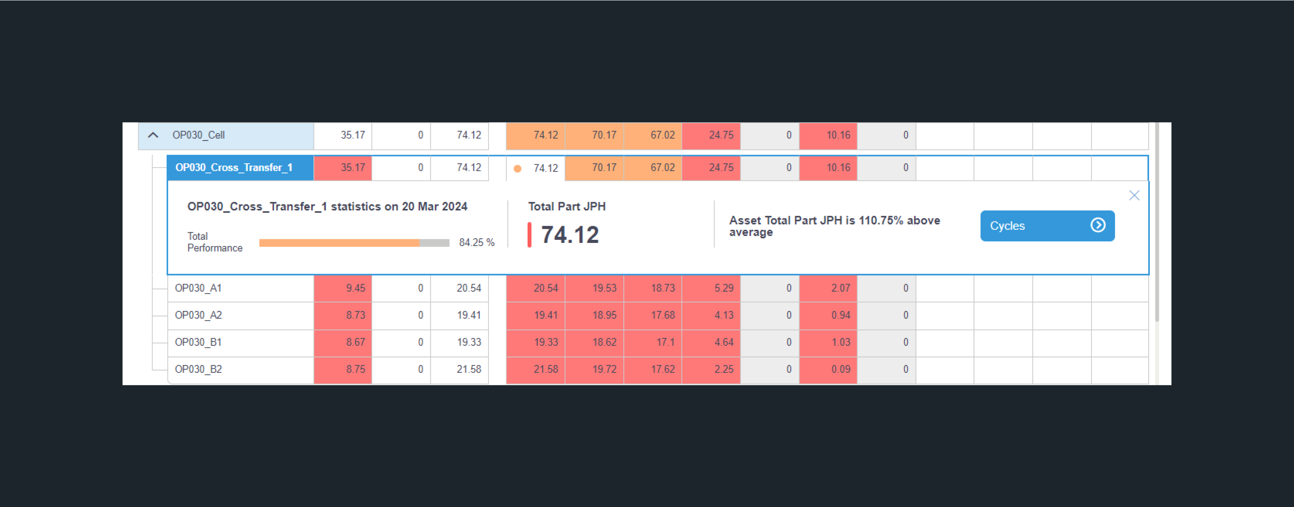

Asset Interval
Selecting an asset interval shows the Total Part JPH asset summary for that specific day / hour on the heatmap. Clicking on the asset interval allows you to drill down to Cycles (Asset Performance).
